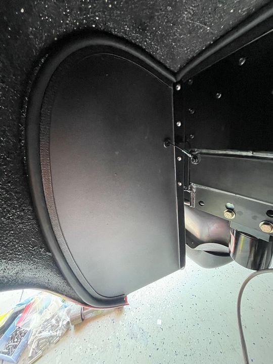

    • Lights - I've got to get the front and rear lights installed. For some reason, although my turn signal lights are working, they are getting a faint glow when the car is on but turn signals not actuated. I'll look again once I get them hooked up as I think I may be getting a ground short somewhere.
    • Splash Guards - Fitted and Installed

    Splash Shields - Rear
    Really not a fan of fitting these. I had failed to bring them with me when I dropped the car off for paint, as the painter would have installed them, but that's life. So I started on these and although I know I've read a few times that you don't need to trim them, I needed to trim them.
    I primed all of my panels with the Rustoleum Ultimate Prime, Turbo nozzle rattle can. Man this stuff sticks to anything and had a 10" fan spray tip. Took no time at all. I then top coated with the Rustoleum Pro Rubberized Undercoat. This stuff went on amazing, dried in 30 minutes, came out silky smooth and should cut down on the noise from road debris.
    The little table is a Black and Decker Work Mate. This is my second one and although they are kind of small, they are really handy in doing just about anything when you need to secure an object for drilling, cutting or painting. Very portable.
    Starting with the rears, the passenger side went in perfectly after the 3/4" bulb seal. I tapped four 1/4-20 holes into the 2" and 3/4" tubes and secured. You don't need to remove any rivets that you might have in the tube for the rear trunk wall panels as the panel just conforms around them when you tighten the bolts. I saw someone ask about that before. I had already tapped for a ground to my Lemans cap and didn't want to change it so popped a hole and grommet into the panel and passed the wiring through. Came out nice.
    Next up was the driver's side rear and this one I had to trim. It barely fit without bulb seal, so not sure exactly what was going on. Maybe the extra few passes of the undercoater in the wheel wells made a difference. I took off about 1/4" all the way around on the outboard side and it fit perfectly.
    One thing to note is the direction of the bulb seal can impact whether the panel fits or doesn't, as it tends to flip flop to one side or the other.

    Splash Shields - Front
    Regarding the fronts, no matter how much I fiddled with them, I could not get them to fit flush all the way around. They kept hanging up on the bottom. I saw on Paul's 20th Anniversary build thread (the gift that keeps on giving), he had the same issue and cut a piece off the bottom. I did the same as well as adding in 1" bulb seal instead of 3/4", which filled the gaps up on both sides nicely. The number on that is McMaster Carr #1120A191.
    I have a small L bracket to attach the splash guard to but haven't installed them yet. I don't think I ever did on the last build and never had issues as the bulb seal seems to keep everything from moving, but we'll see as I'm not going to drill into the body unnecessarily. These are all secured by eight 10-32 screws to the F-panel, so it's not going anywhere.
