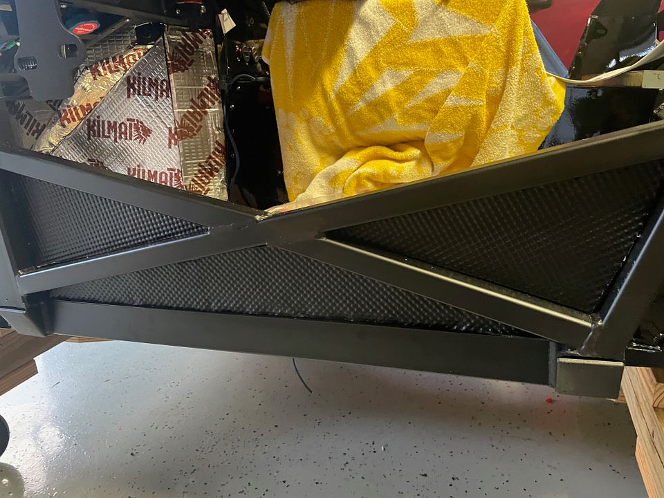

Originally Posted by
cv2065
I extended the Kill Mat into the floorboards and tunnel, but because my dash 'workstation' is sitting on top of that, I don't have any pics right now. However, I did remember that the one place I used to get heat from in the last build was right at the door where the side pipes ran. The heat didn't blow in, but the radiant heat was certainly noticeable on hot days. I decided to insulate that part of the door on both sides. I used a 10 mil black tunnel heat shielding from Design Engineering. It's rated to 1,750 degrees. I may put some on the front of my footboxes but haven't decided yet. It's pretty stout but cuts fairly easily. I bought it here:
https://www.amazon.com/gp/product/B0...?ie=UTF8&psc=1
Every time you post I spend money. Got this last week. Thanks…. I guess? I kid. Great to follow along
