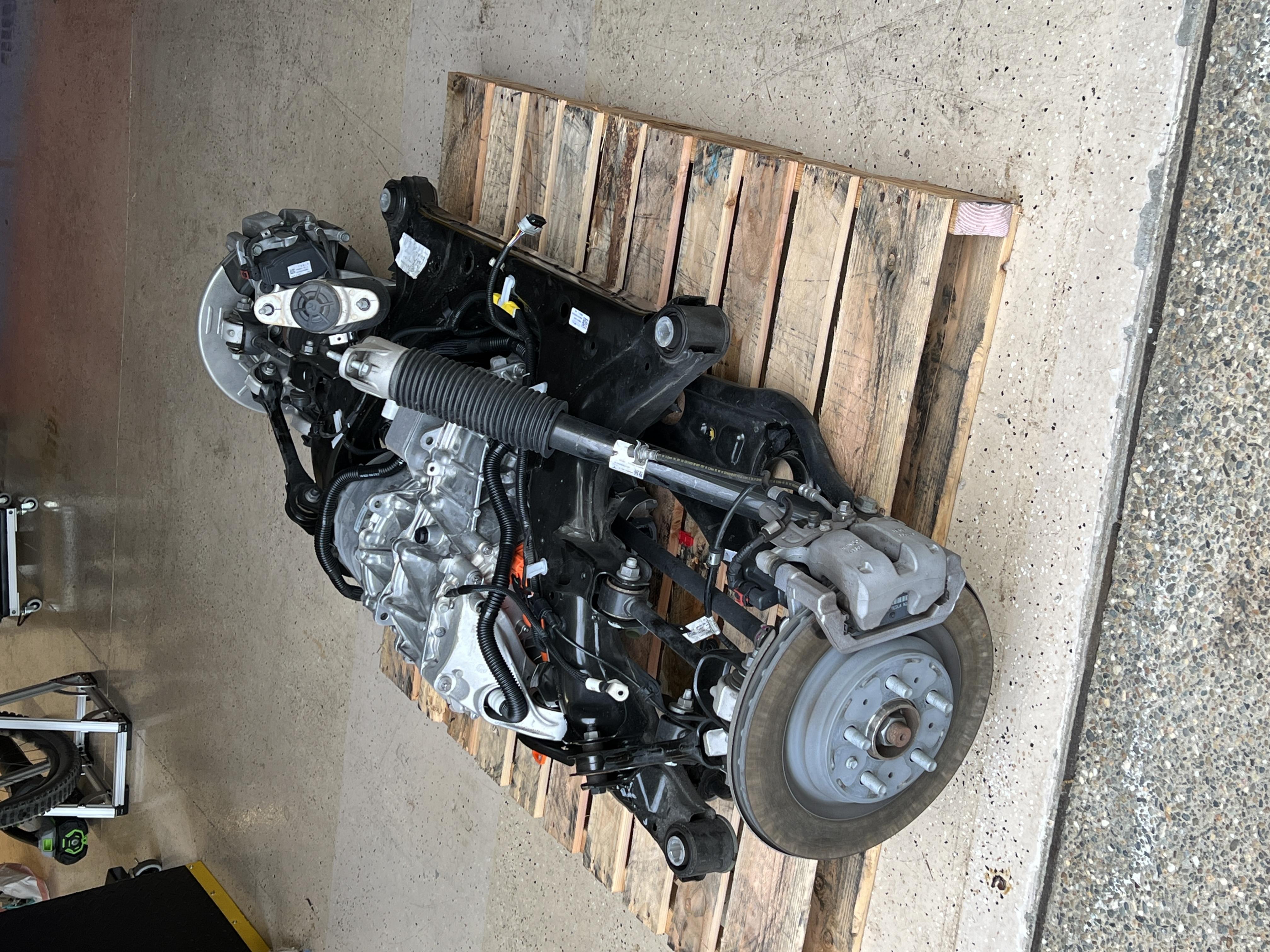

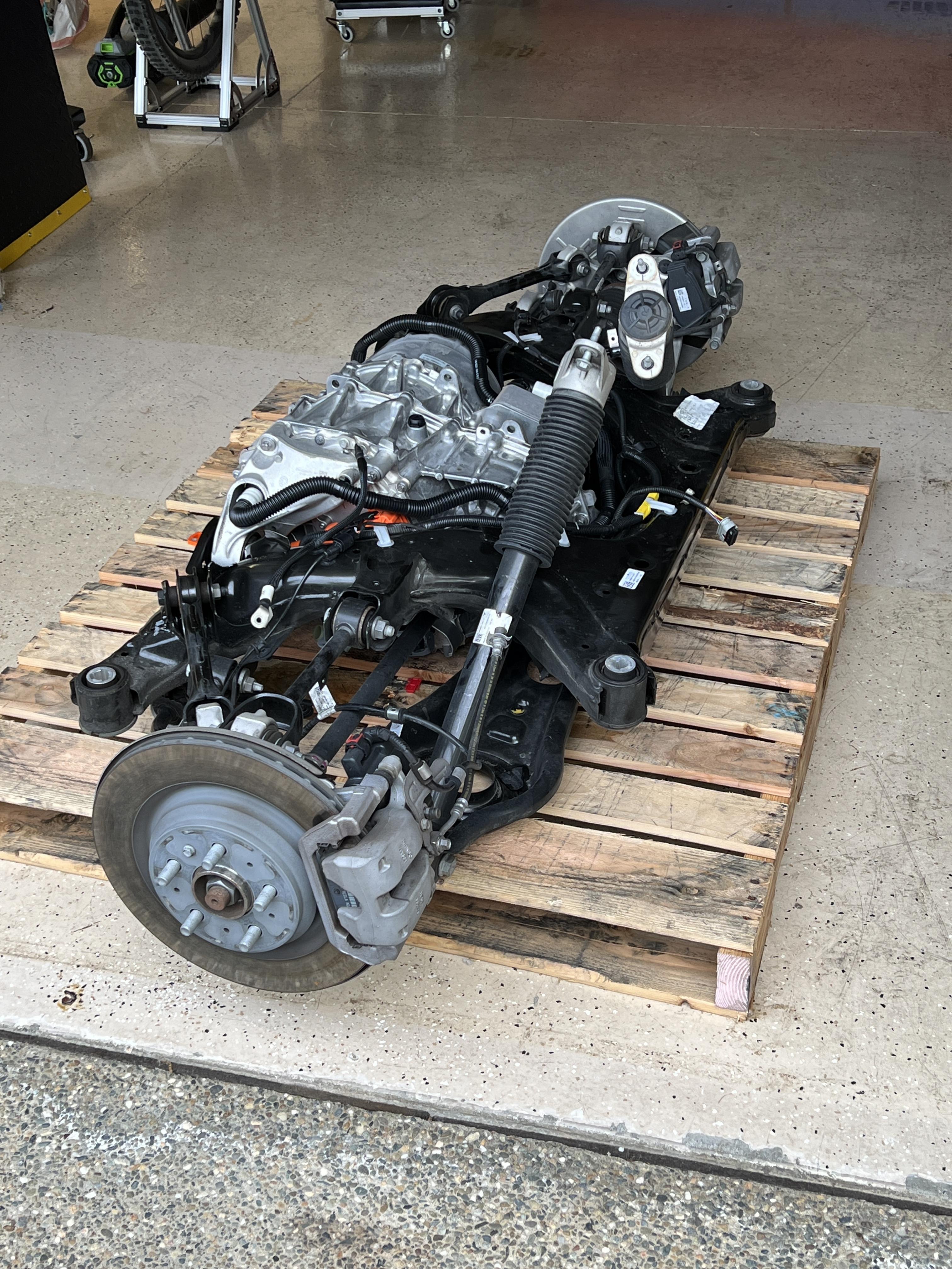

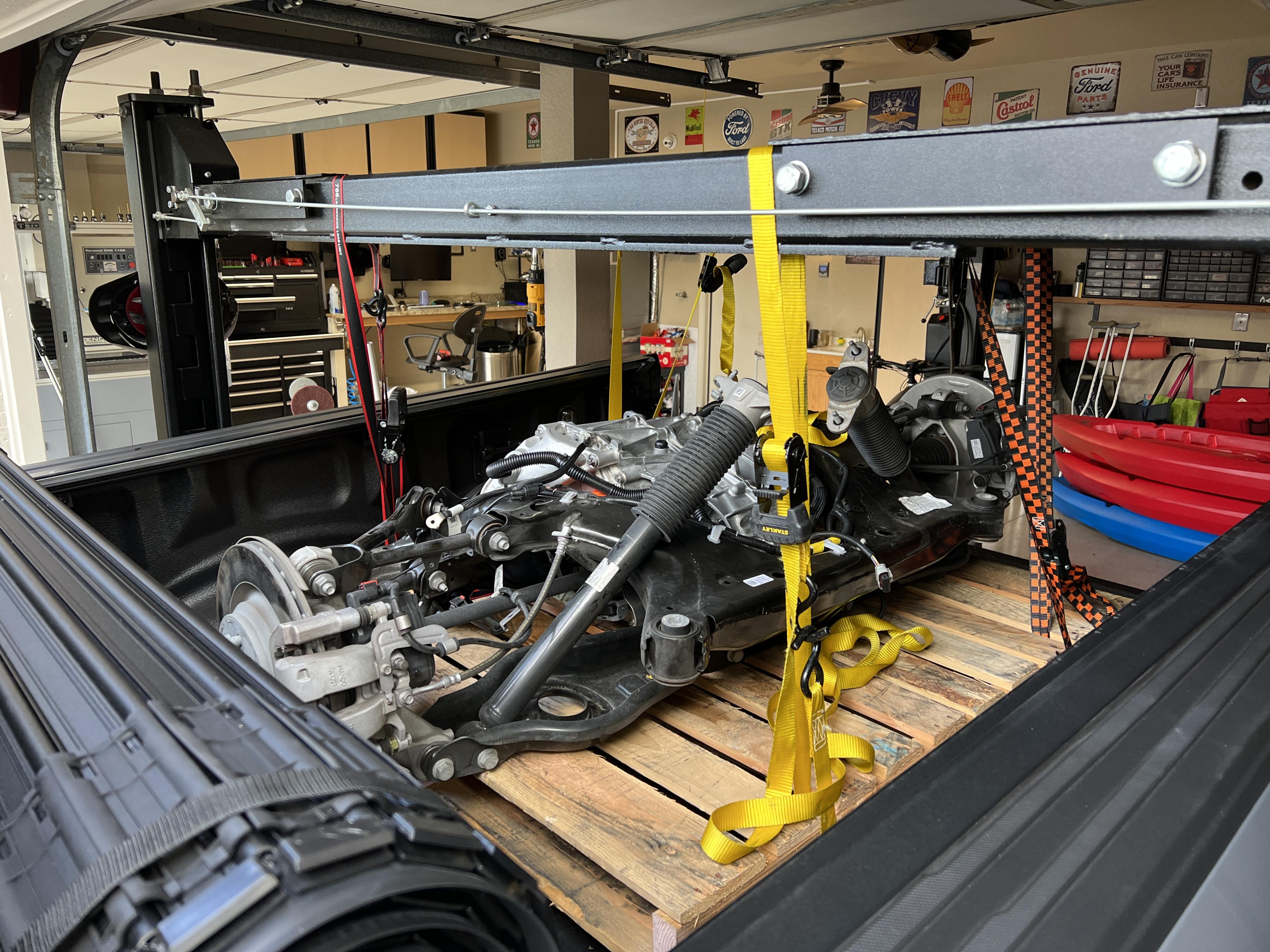

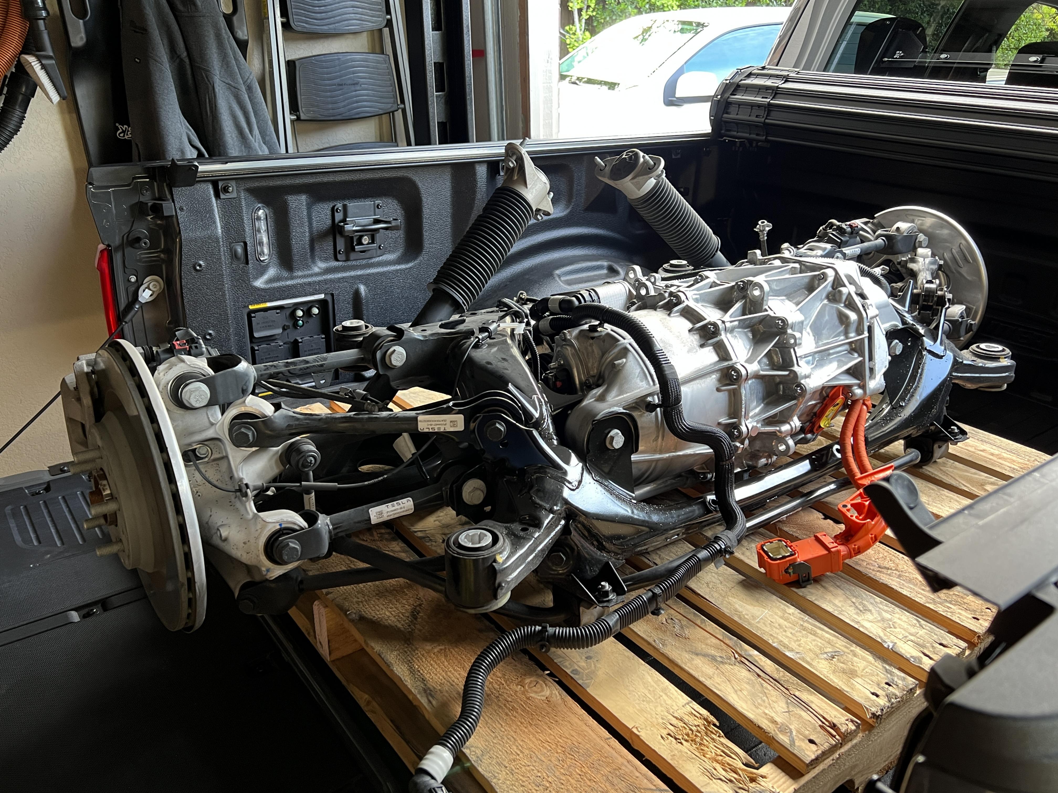

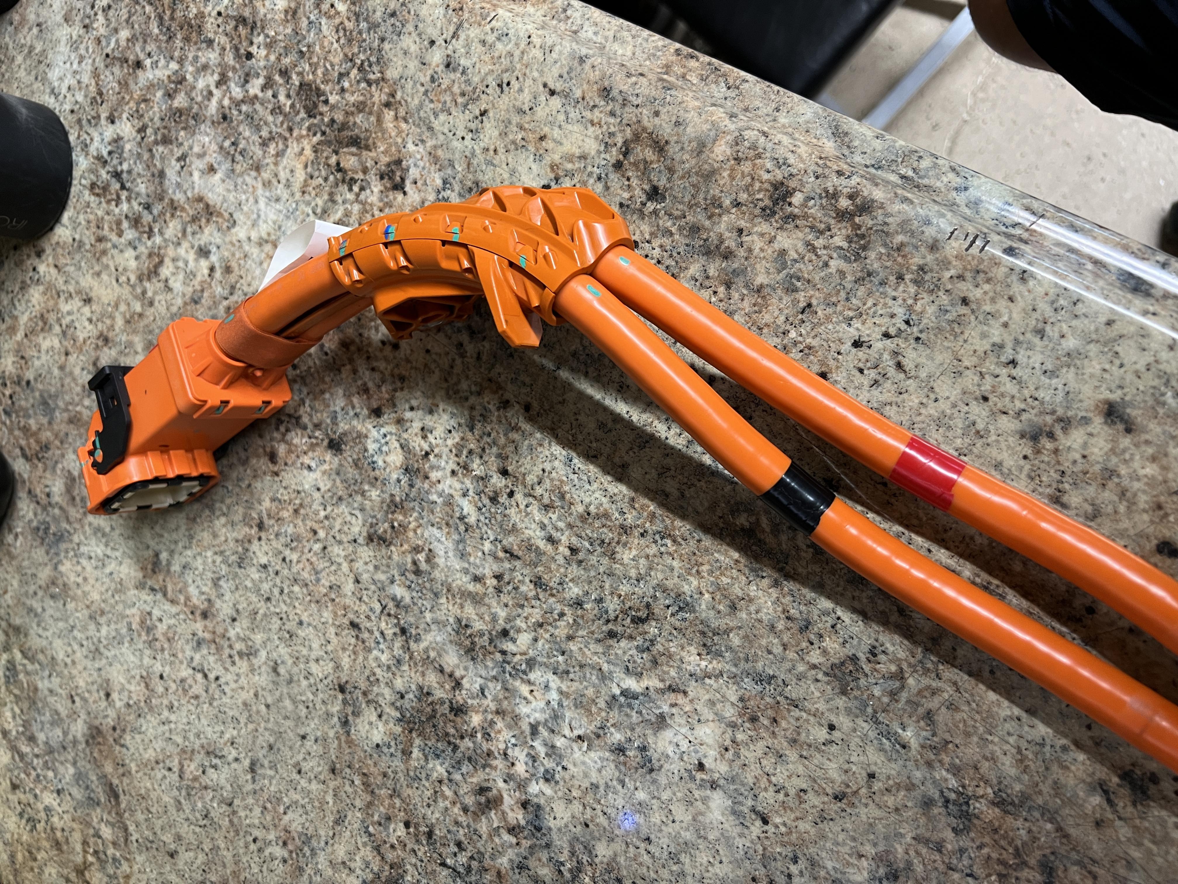

    Here is the drive unit I found..
    I don't know why the rotated image is showing as an attached thumbnail... oh well.

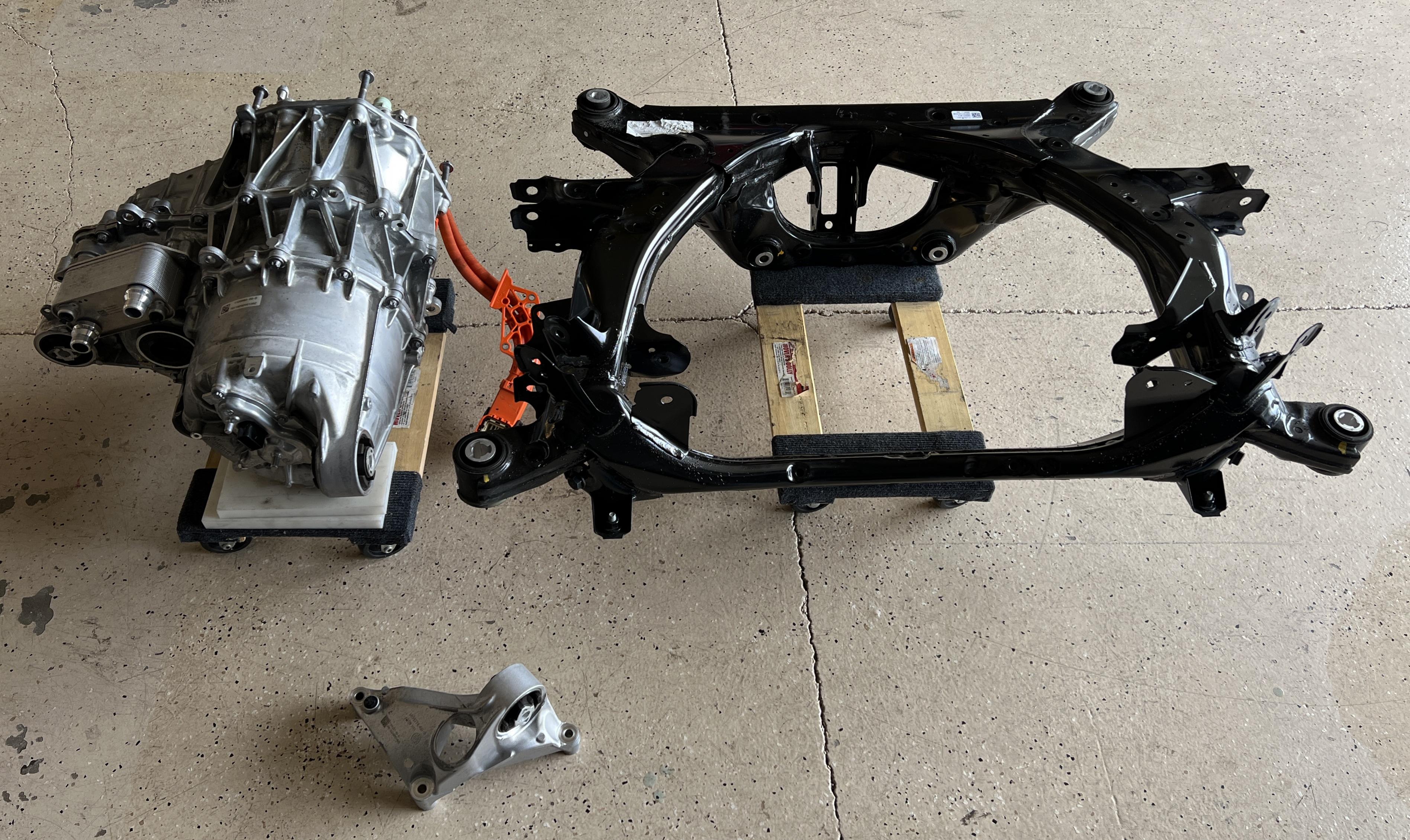

    507

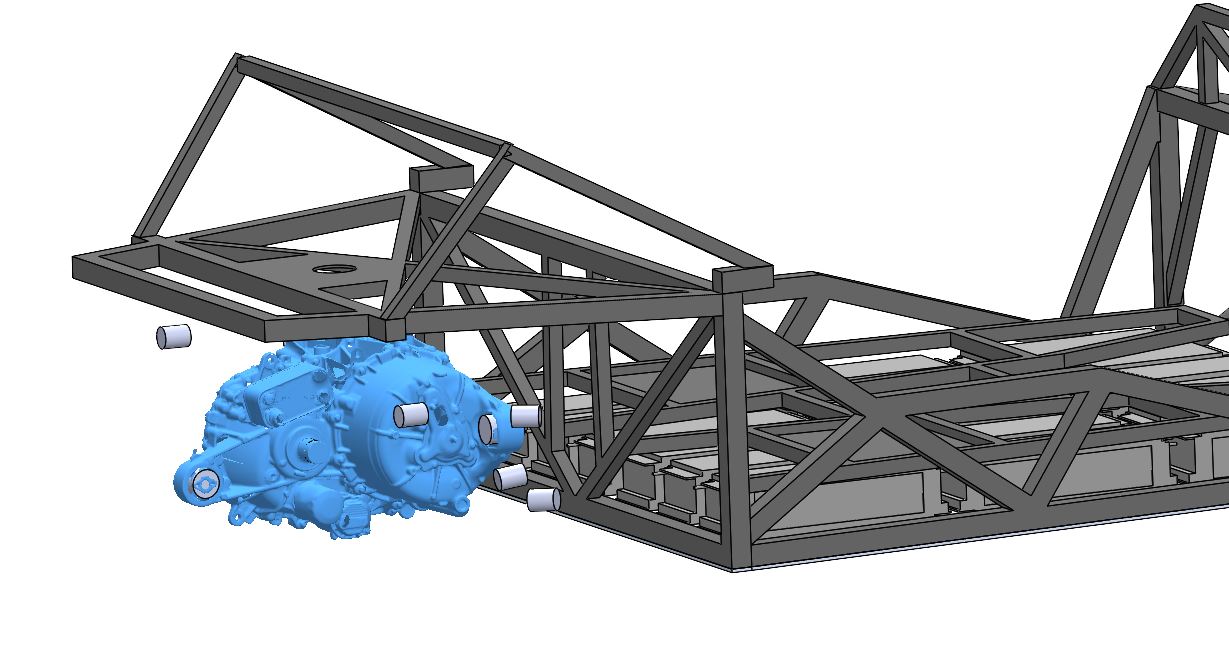

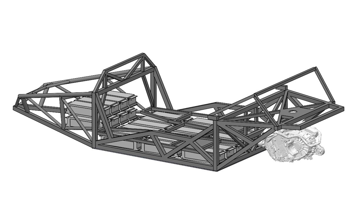

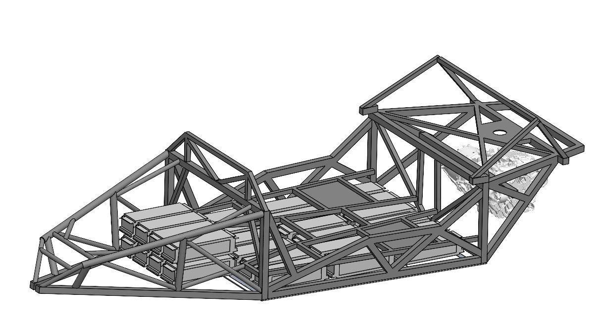

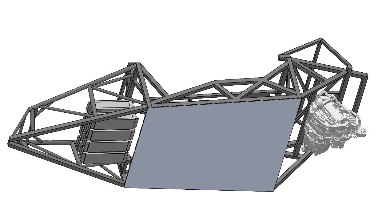

    This is the current layout for batteries along with a rough CAD model of the motor I found online. I plan to do a better scan of the actual motor I have soon. The chassis CAD model is made from images online but it's a reasonably good start. Once I get my kit I'll adjust the model to match exactly. Sure wish FFR would provide CAD models, but I understand that's their policy.

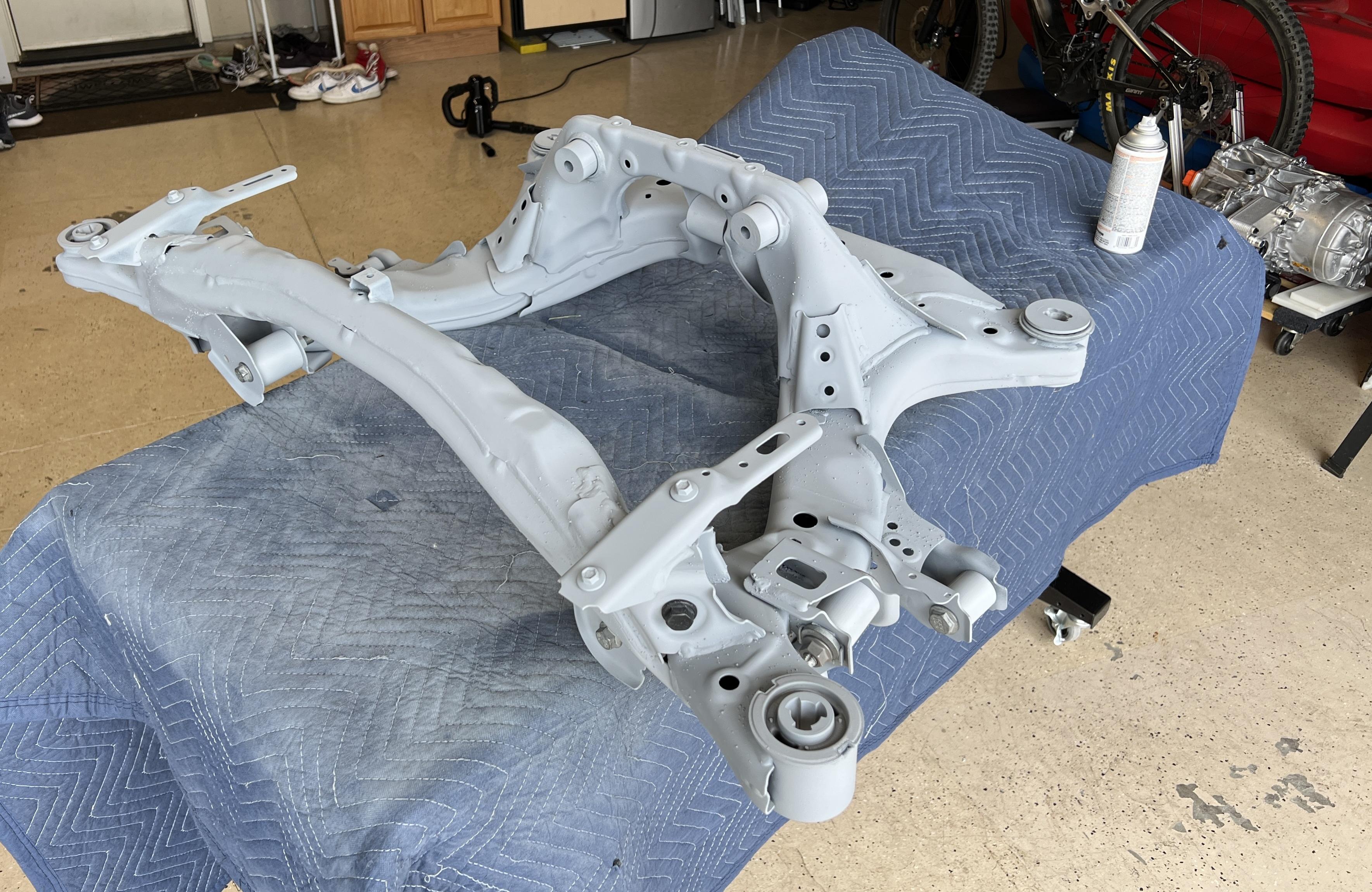

    All apart and pretty much ready for 3D scanning. Still learning the new scanner I bought so I'm sure it will take a few attempts to get it all right.

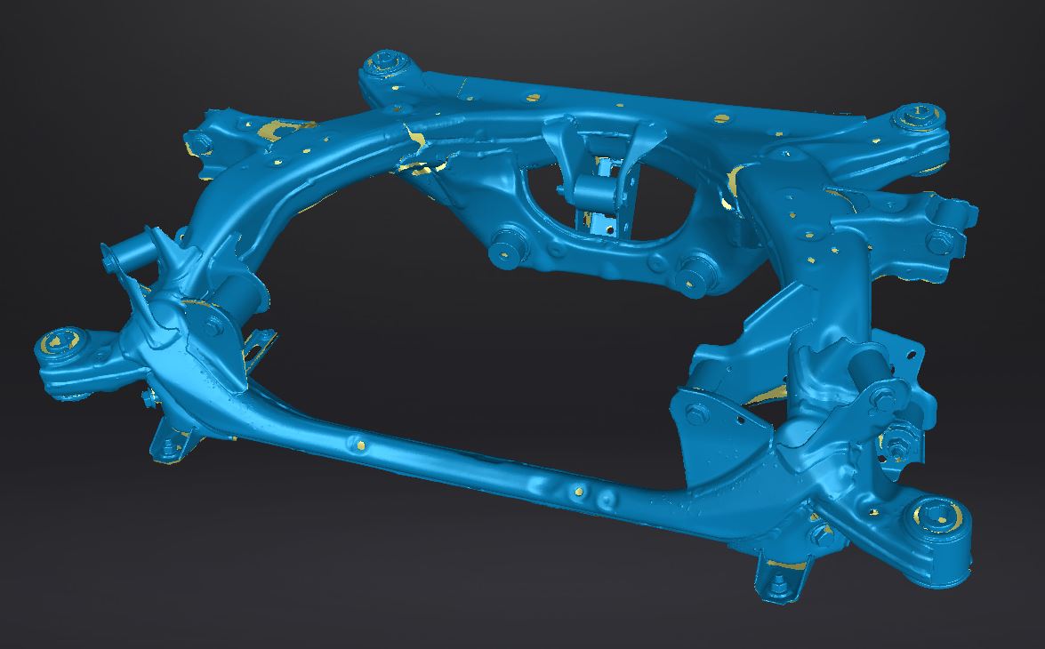

    507

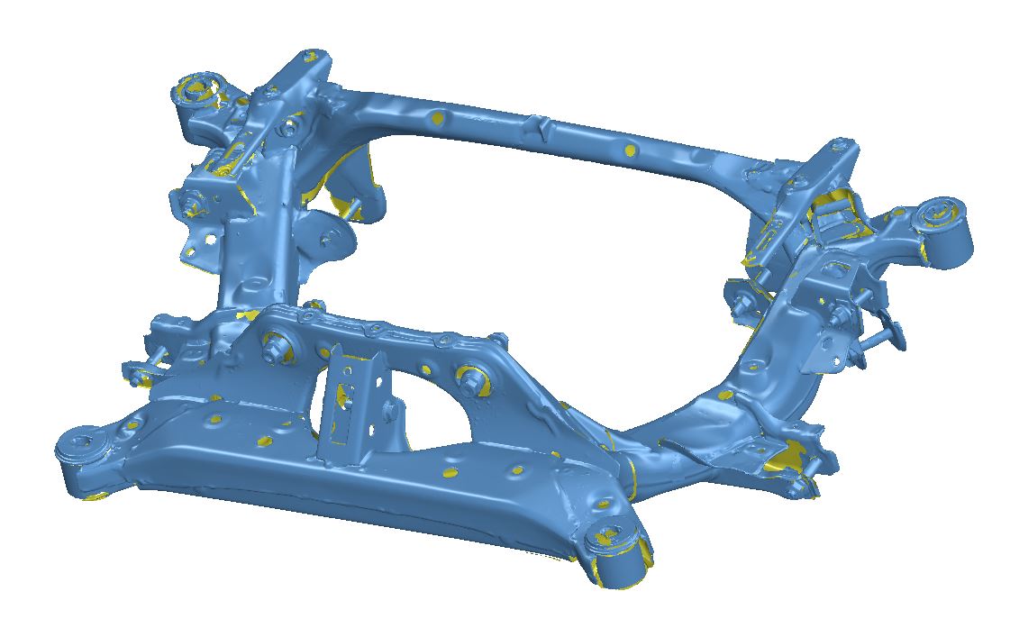

    After several hours messing with the scanner I was able to piece together a first pass scan of the Tesla subframe. I took a few quick larger measurements and it's close. I might have to make cylinders to bolt in where the suspension links mount to provide larger surfaces to scan. I tried it here with just the bolts and I'm not sure it's going to give me the best results.

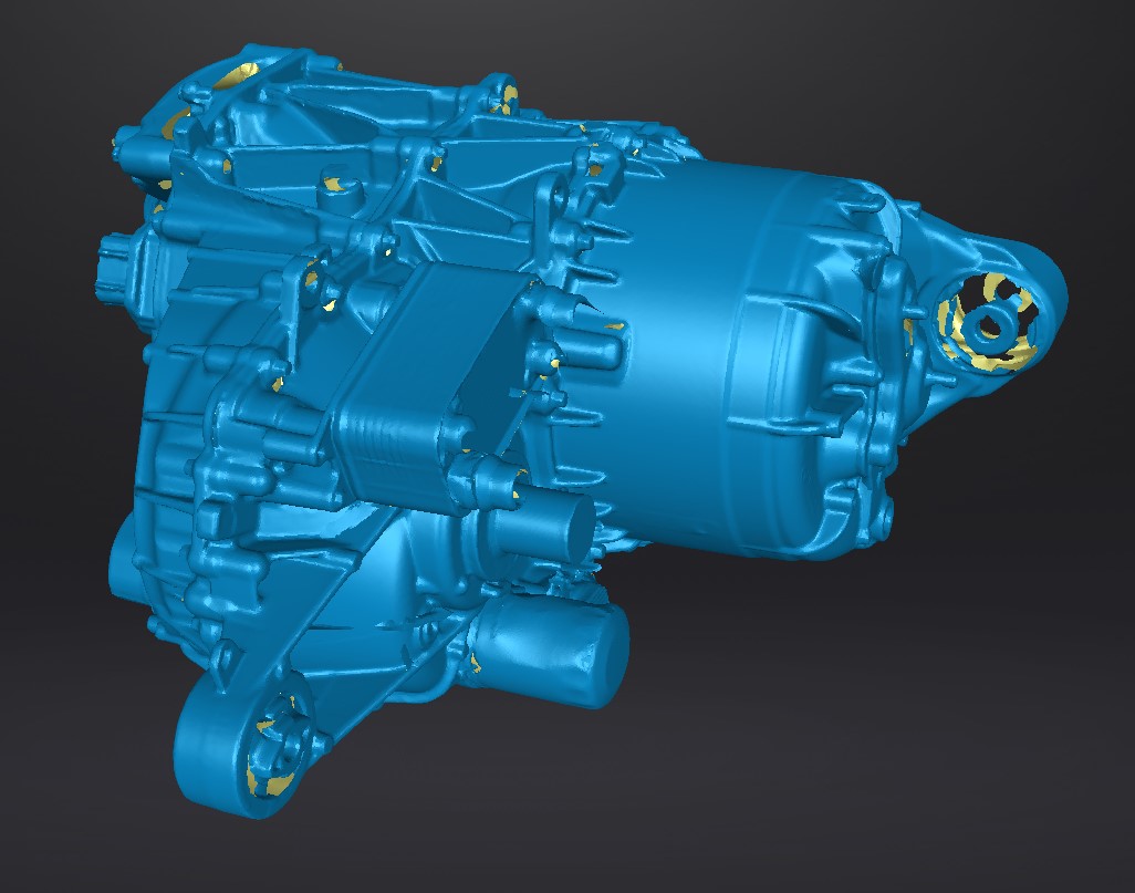

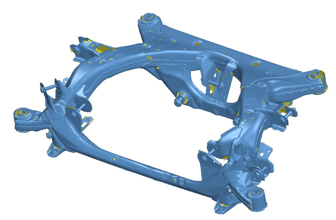

    Got the 3D printed cylinders done to help better locate the pivot points in the scan. So far it's going well - scanning much better.
  28. #21
    507
    MUCH better. I'll mess with extracting geometry from it tomorrow..
  29. #22

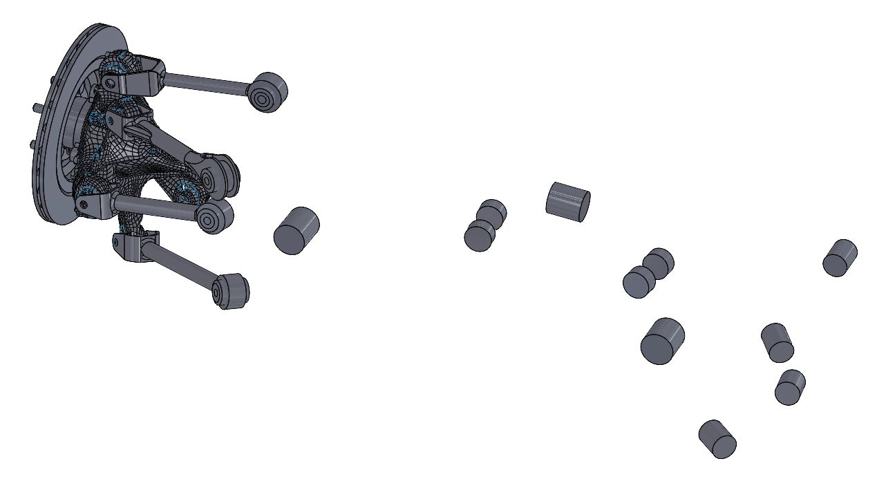

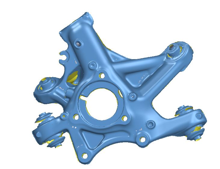

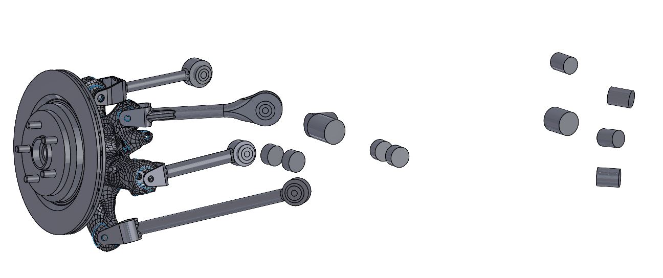

    507
    Made good progress on the scanning and CAD work for the drive unit and suspension. I have the suspension pivot locations pretty accurate it looks like. I assembled most of the links to the hub and everything lines up really well. I'm not going to use the Tesla main lower control arm because it's kind of ugly stamped metal. I ordered aftermarket ones from Mountain Pass Performance that are much nicer and will allow for easier conversion to coilover. I'll probably end up getting their full set for the nicer look and extra adjustability.
    The small cylinders are the suspension pivots and motor mount locations from the subframe scan.

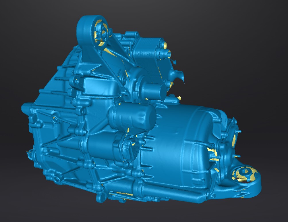

    Motor scan is done....

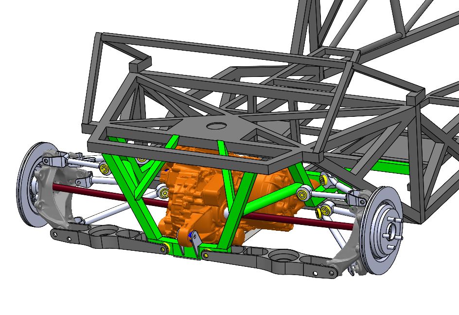

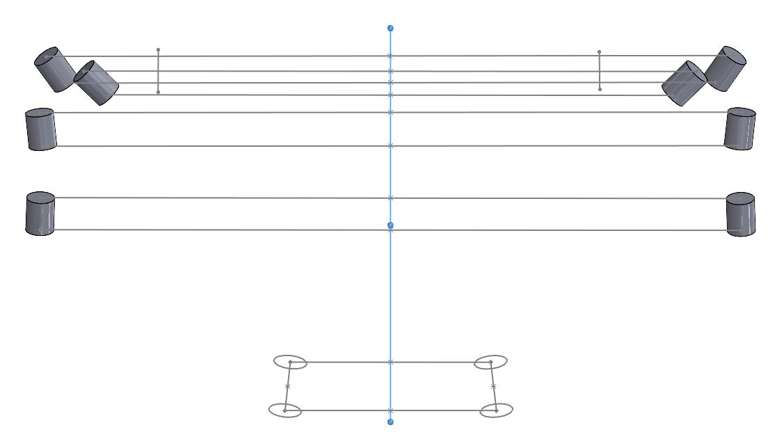

    Wow! I did a centerline check on the subframe scan results. This is drawing a line from the small pivot cylinders on each side, then placing a point at the mid point of each line. I fit a plane to three of the points and used that to check where the rest of the centerline points are relative to the plane. It's dead on! I actually expected some error but this is perfect.
    I need to do more work on the motor scan because I had trouble extracting exact centerlines for the mounts. The 3D printed cylinder trick should work though. Once I get that I'll be able to fully locate the suspension in the chassis CAD model.
  34. Likes Pat Landymore, David liked this post
  35. #27
    507

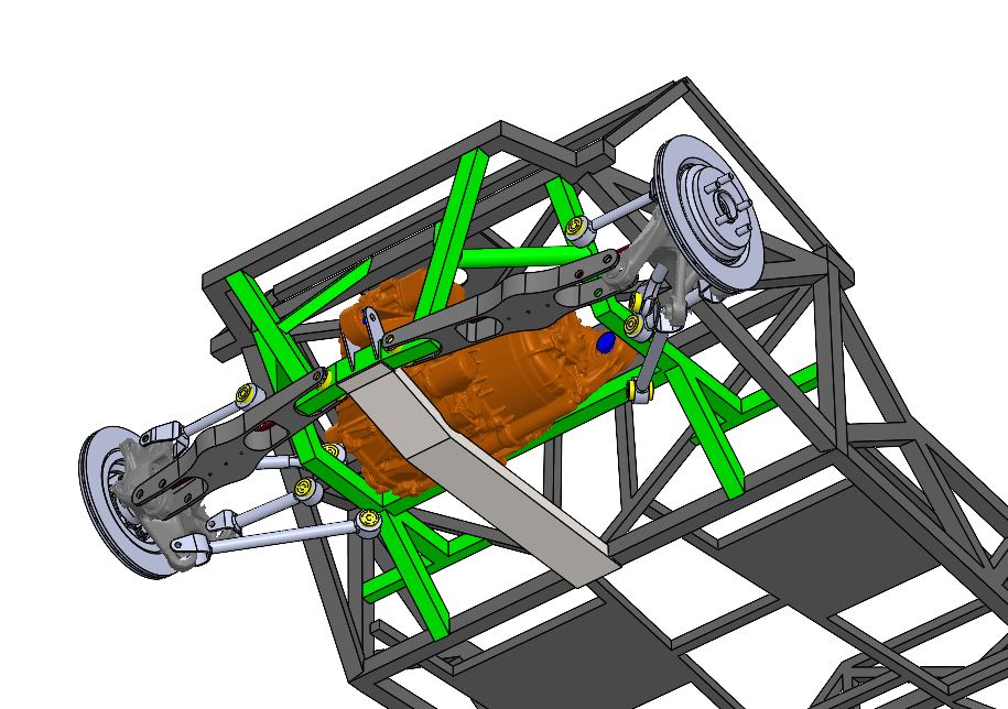

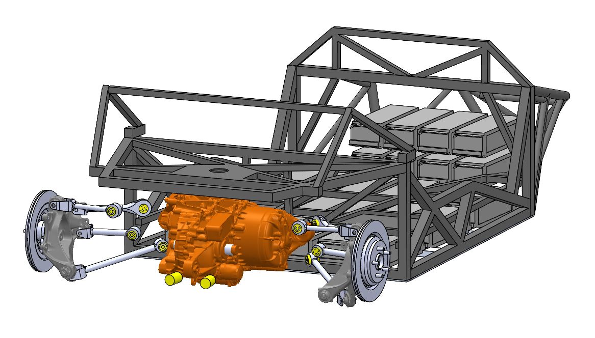

    This is the rough motor placement along with the stock Model 3 suspension pivot points. Next I need to pull the pivots inboard to get the width where it should be. I can start thinking about the chassis/suspension design at that point but I won't be able to do much in detail until I get my kit. The chassis CAD model needs to be correct first.

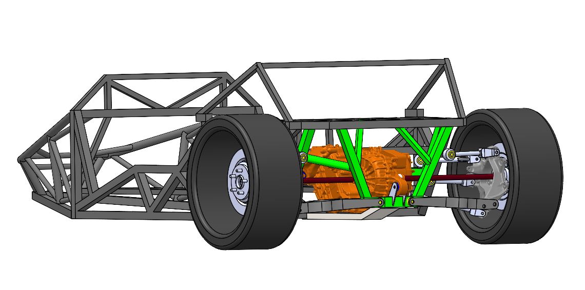

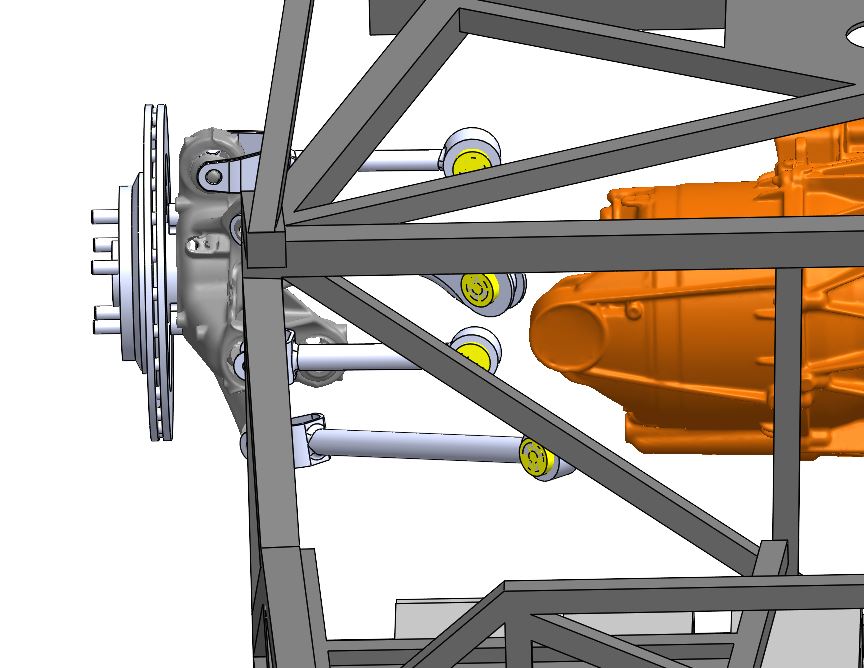

    Spent a while today working on the CAD file. I started with the ideal situation matching the Ford rear end width of 59.75" hub to hub. That would give me the most flexibility with wheel selection, but it looks pretty tight in terms of making new chassis mounting. I was hoping to be able to use square tubing with simple mount flanges but I can get more elaborate if need be. I can also push it back out a bit too. It just means less dish on the wheels and likely custom backspacing.
    I should receive the new lower control arms Thursday and will add them in once I get the part modeled.

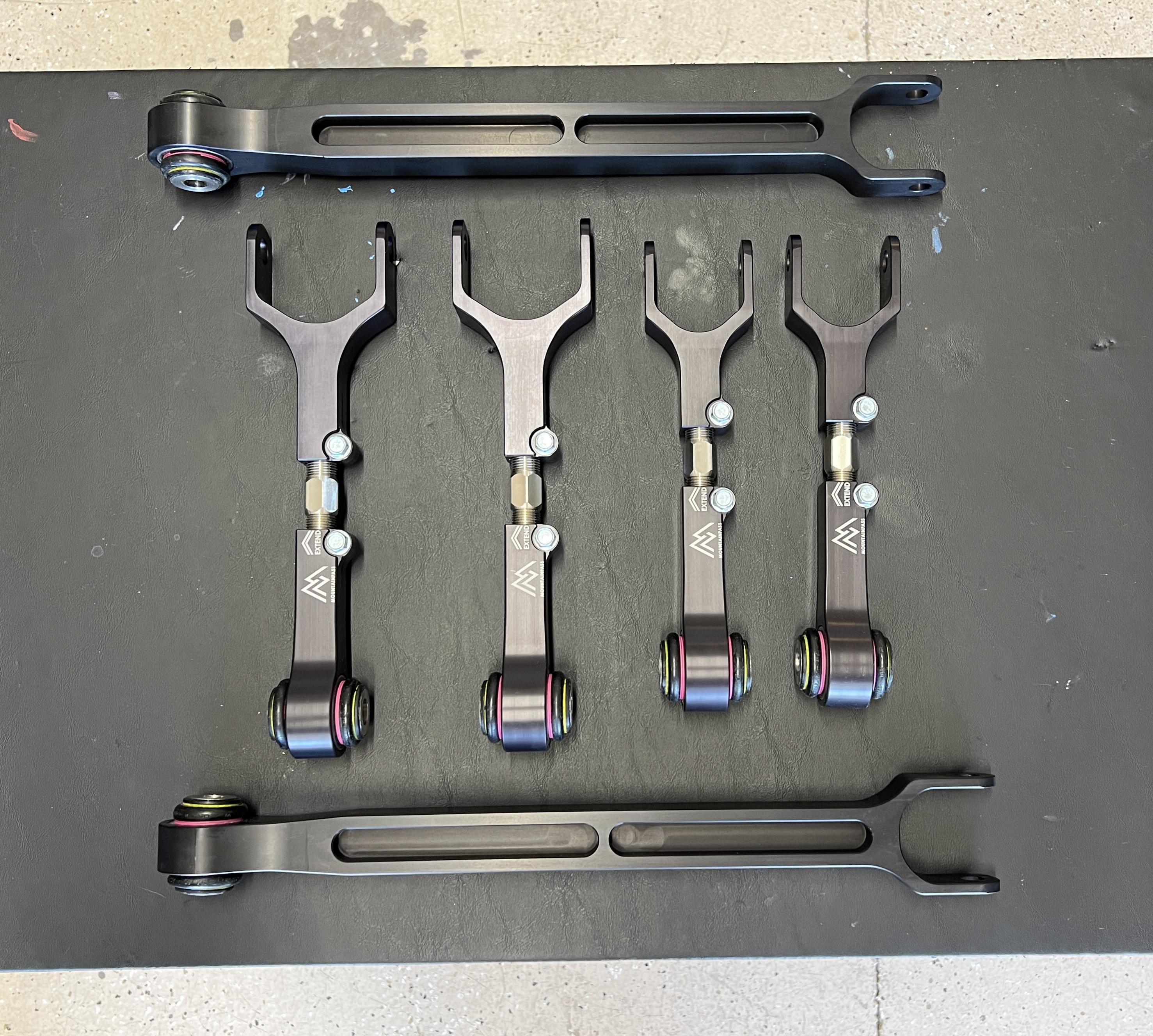

    507
    I got the MPP lower control arms today - scanned them and made a CAD model for the assembly. I've also done a bit of work thinking out the chassis changes needed (in green). I definitely see a path to make it all work which is a big relief. Whether the final ends up exactly like this or not at least there doesn't seem to be any major show stopper problems right now. It also looks like I might be able to keep the stock rear deck support struts. The front upper control arm interference doesn't look as bad as I was expecting. I might be able to just notch out clearance spots and add some gussets to cover any strength loss.
    Really hope I have the chassis CAD model close. That could change things if not..
    Motor-Suspension Placement 5.JPGMotor-Suspension Placement 6.JPGMotor-Suspension Placement 7.JPG

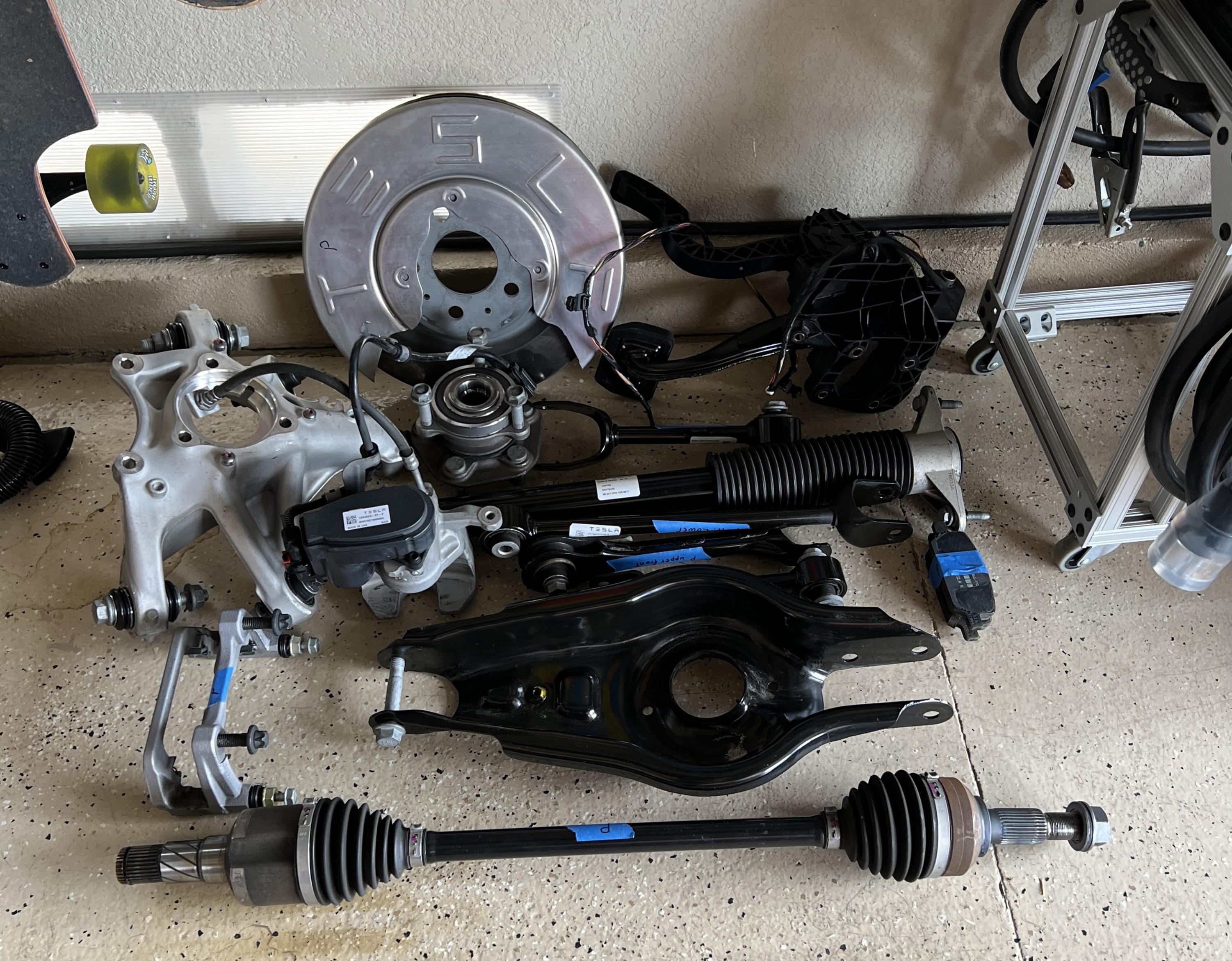

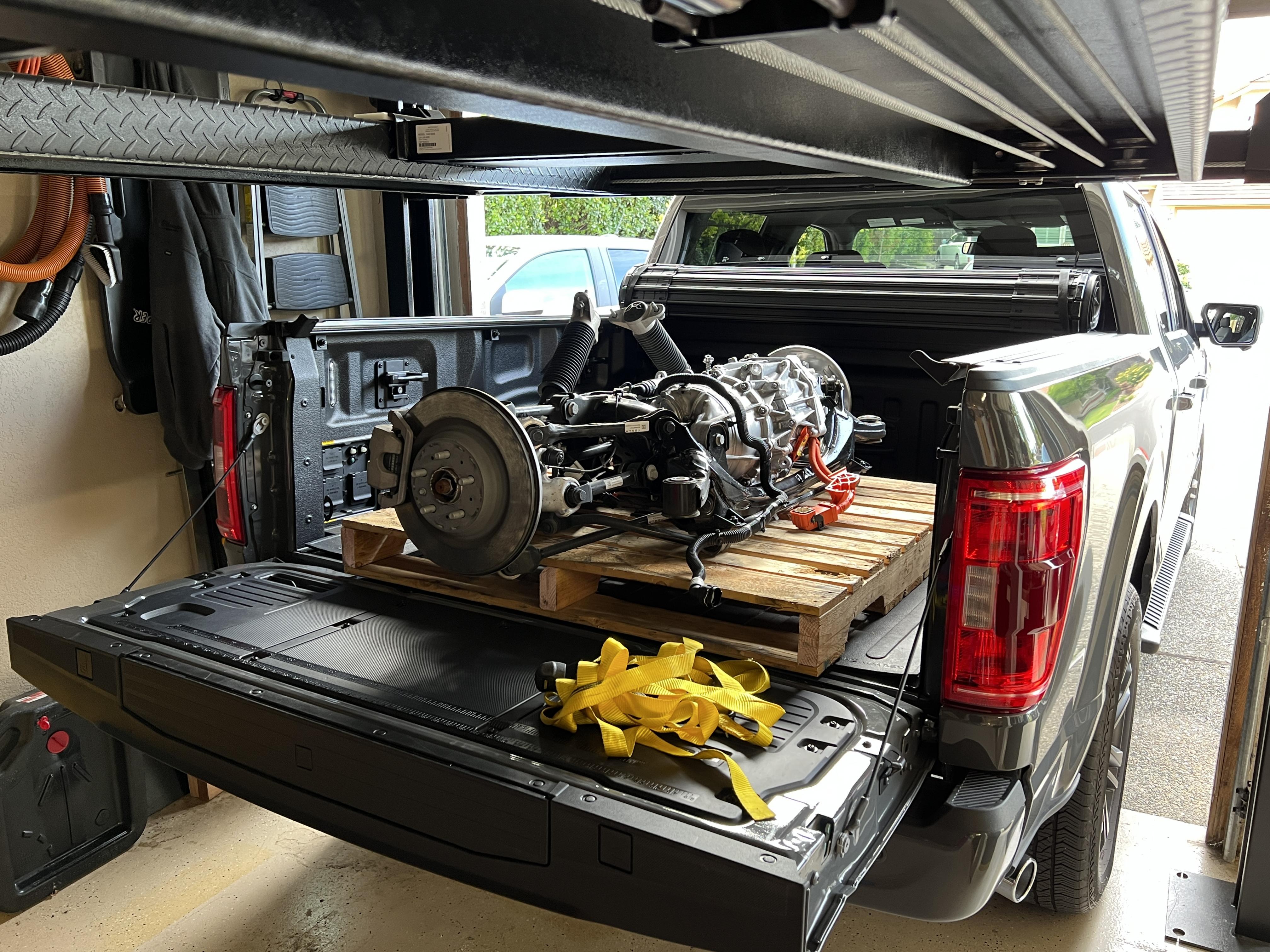

    Got a few new toys today.. The rear trailing arms are backordered which is no big deal of course. These will be a nice upgrade from the stock Tesla arms.
    I talked with the transport company last week. They'll pick up the kit later this week, maybe early next and I should have it here by end of the month.

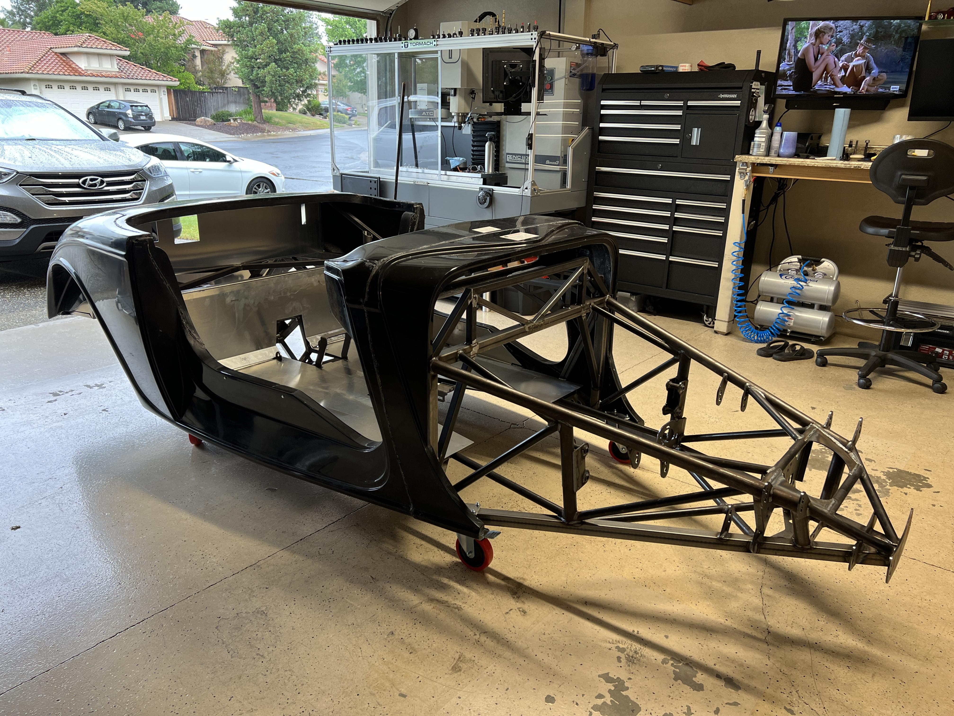

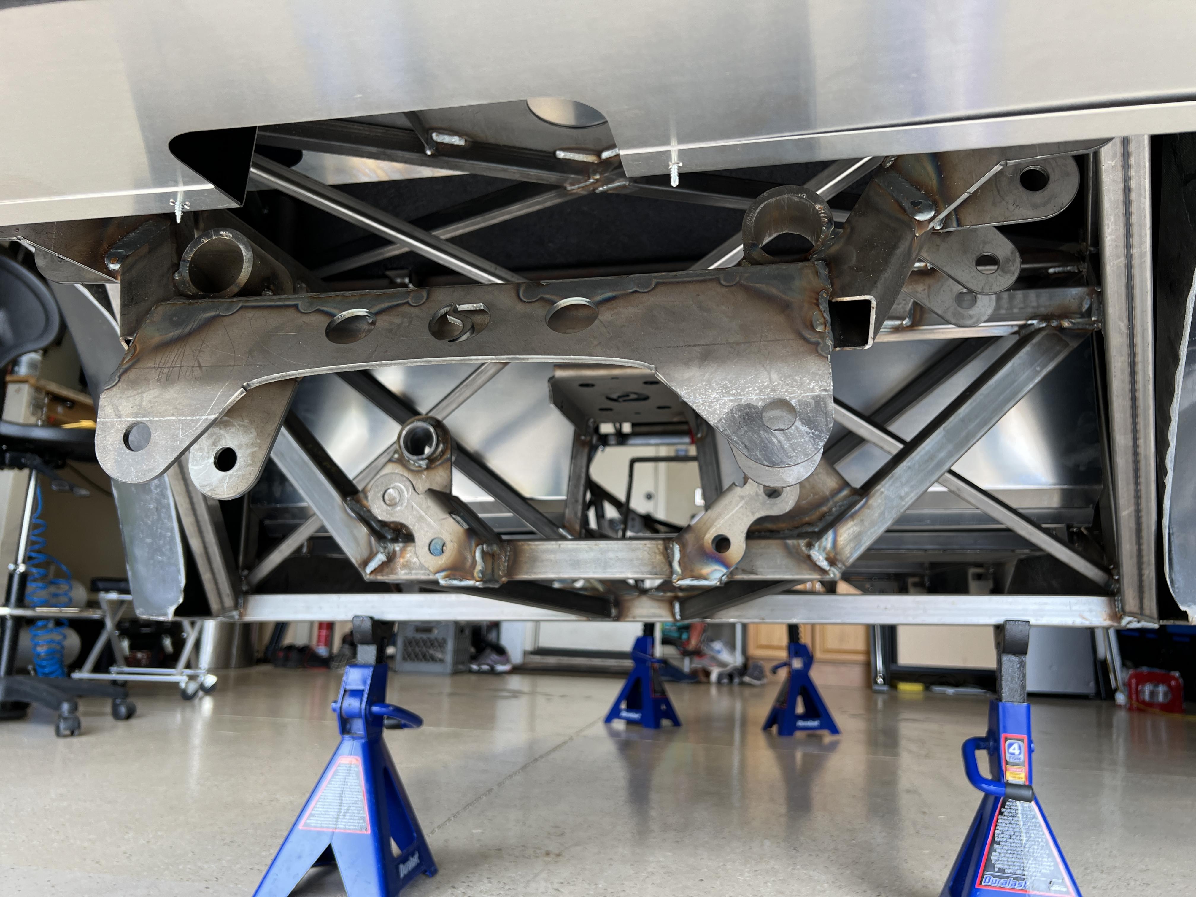

    It's here!
    Busy day yesterday doing inventory and finding a place for all the parts. The backorder list wasn't too bad. The biggest ones were the steering column and front hubs.
    Unfortunately they sent me an IRS chassis instead of the basic 4 link. Must have been some crossed wires on the order because I originally had it as IRS and then changed it to 4 link when I figured out the Tesla motor wouldn't fit. I got the 4 link arms though which is odd. Oh well... It's not a huge deal, just more to remove. I'll try to cut it out clean in a larger assembly. Maybe someone could make use of it.
