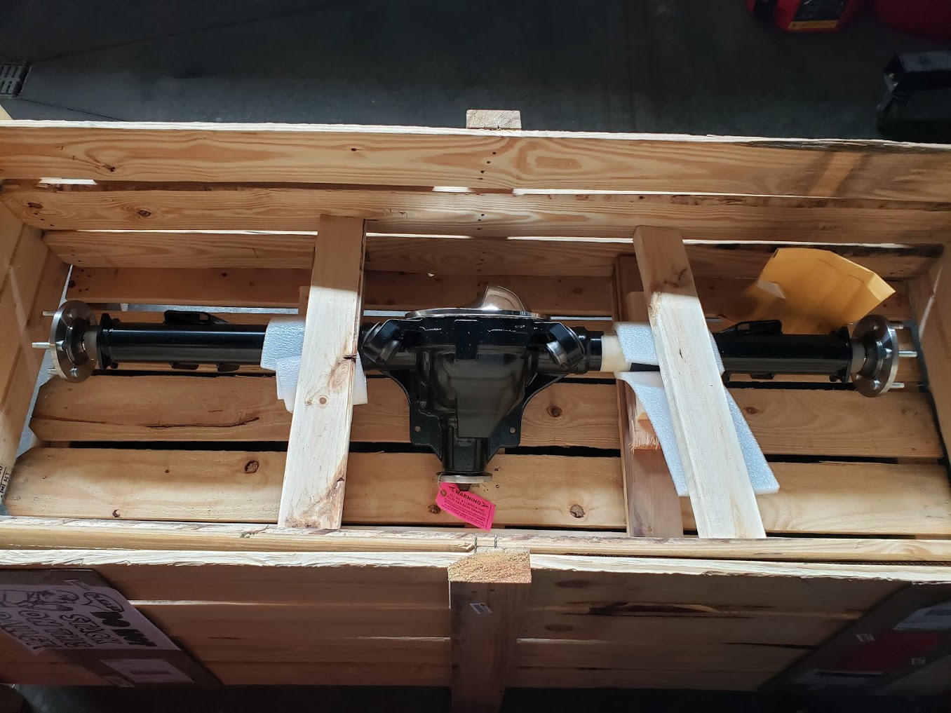

    Wasn't supposed to get the 4-Link Moser Rear end until mid-Aug but it showed up today. I guess I'll use the extra space in the crate to store other parts that might show up until my kit arrives.

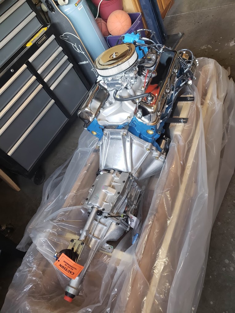

    Engine / tranny showed up today from BluePrint Engines....couple more weeks and the kit should show up.

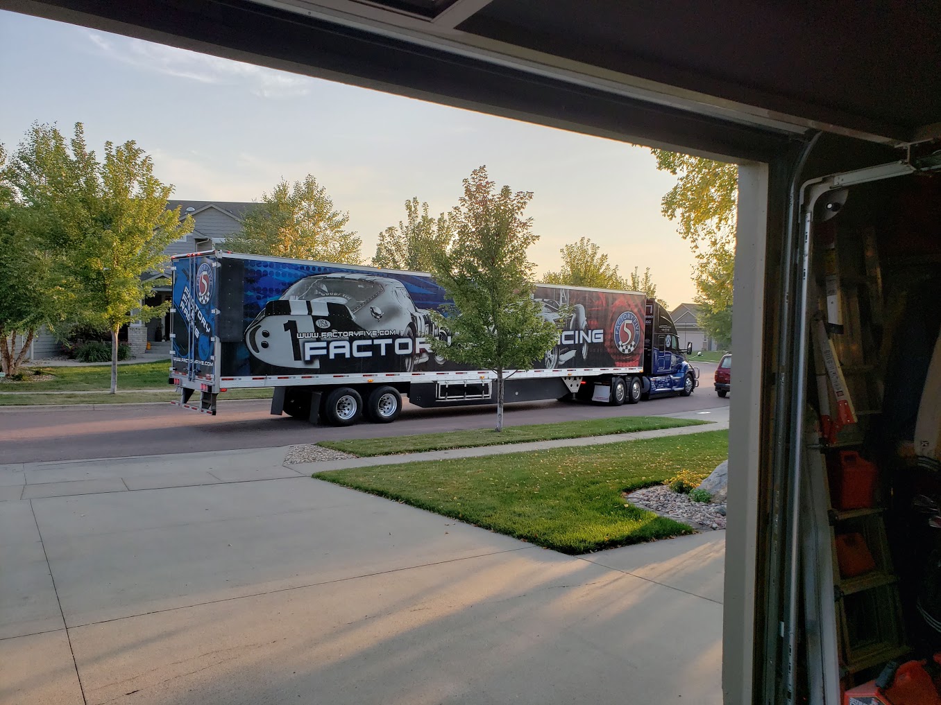

    Just got confirmation from FFR that my 33 HR kit is being loaded on Stewart Tranportation's truck.....should be to me in SoDak by mid-next week. I best be cleaning up the garage this weekend.

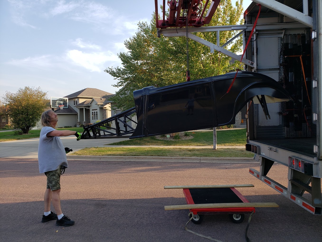

    The wait is over!!.... well, almost. I just got call from Stewart Transport, my 33 HR Kit will be delivered at 8:00 AM tomorrow morning (9/25).....
    It was supposed to be a day earlier but they ran into a few issues with their crane and since they were in Iowa already for a delivery they stopped by the crane manufacturer to get it serviced. All is good now.

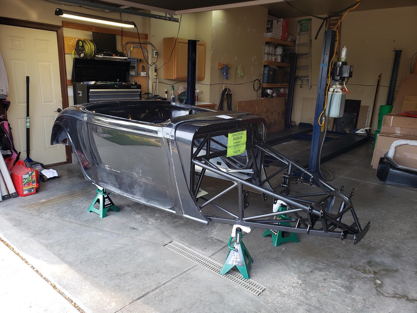

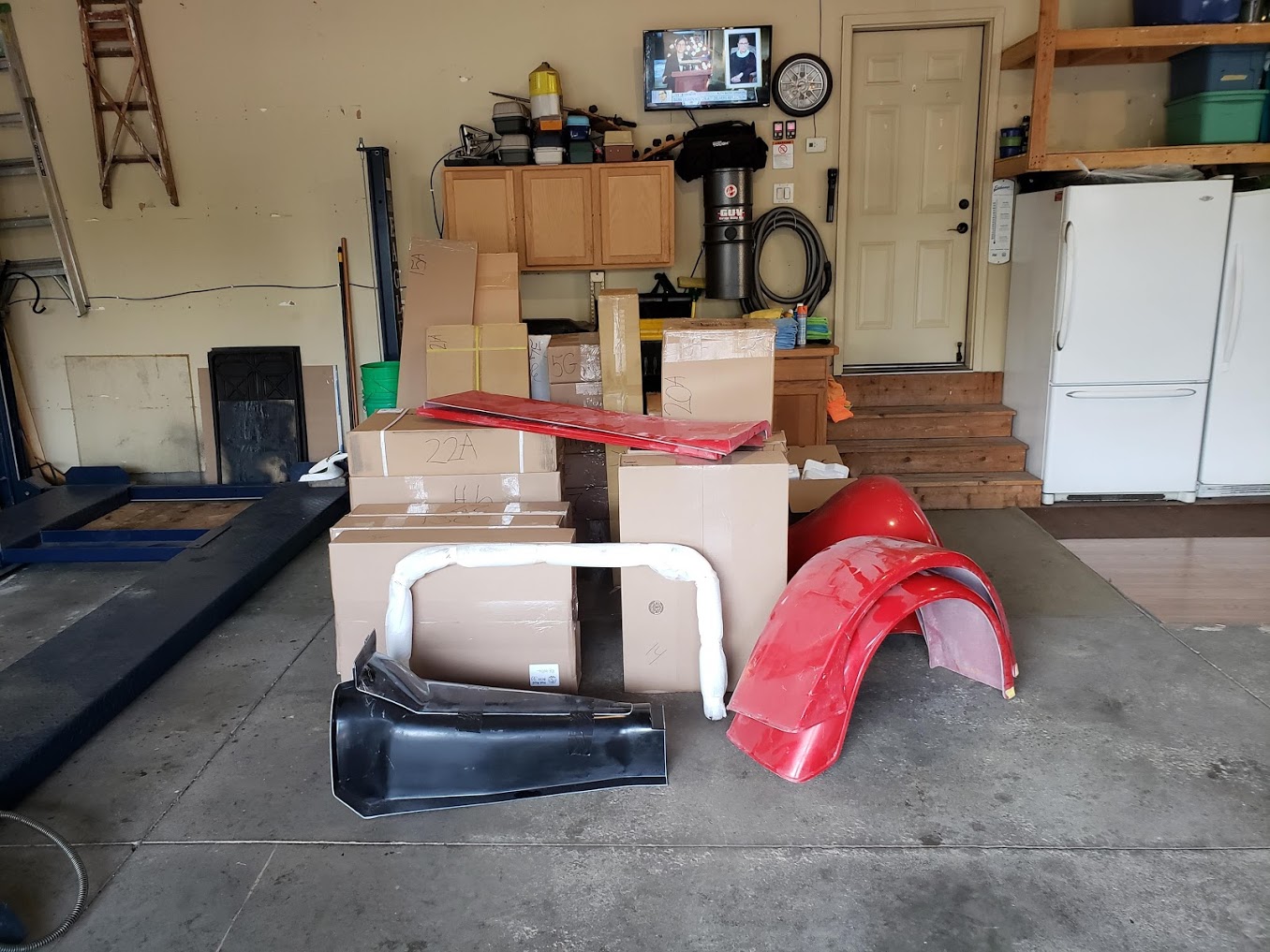

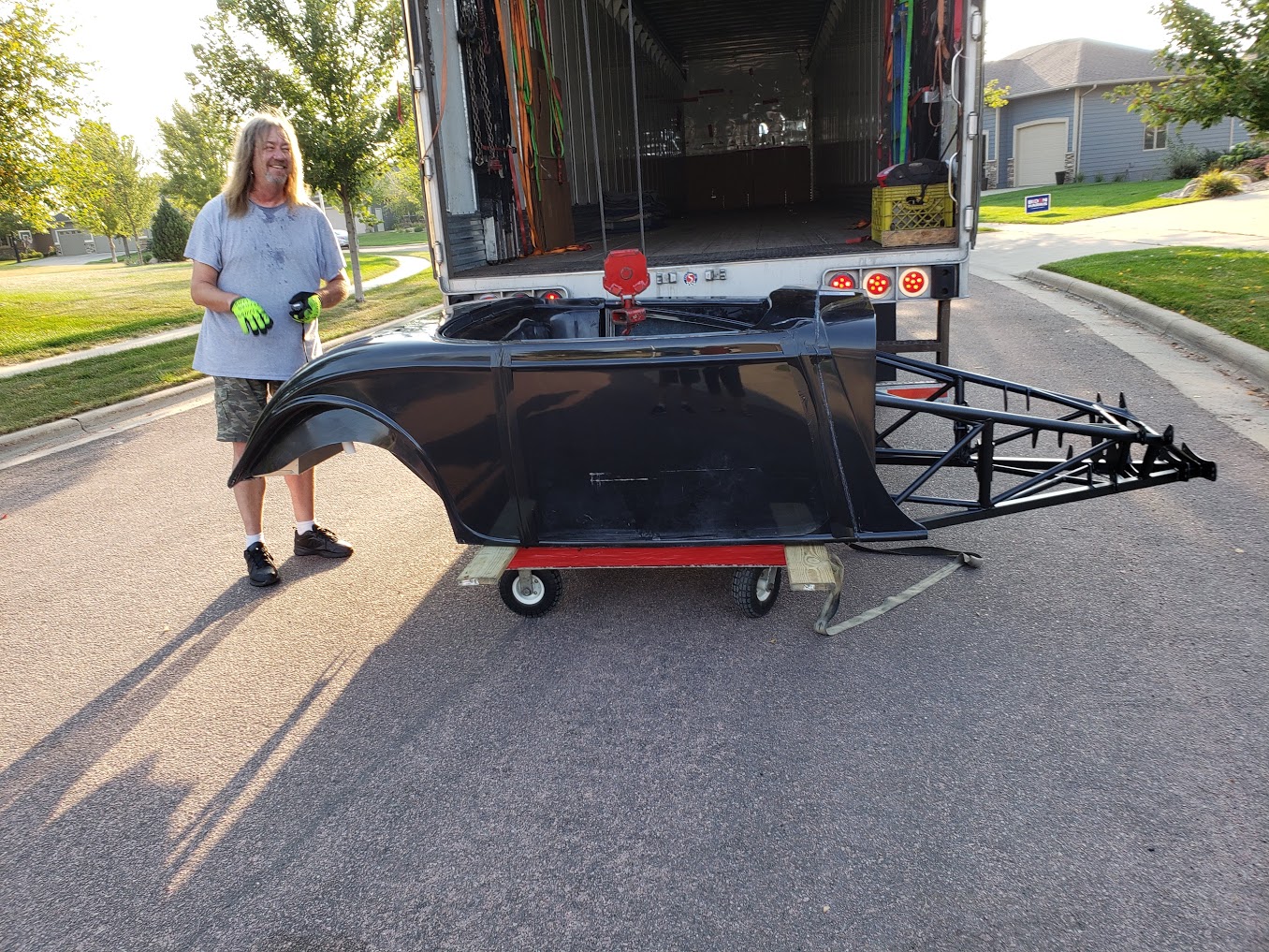

    Car is here...you've all seen this before, but pics attached
    Very neat process to see & experience.....these guys are truly professionals at what they do....The driver's cart didn't fit on my lift (too narrow) so I'll need to build a cart to get it on there which is the first action item...next is doing inventory on the big pile of boxes

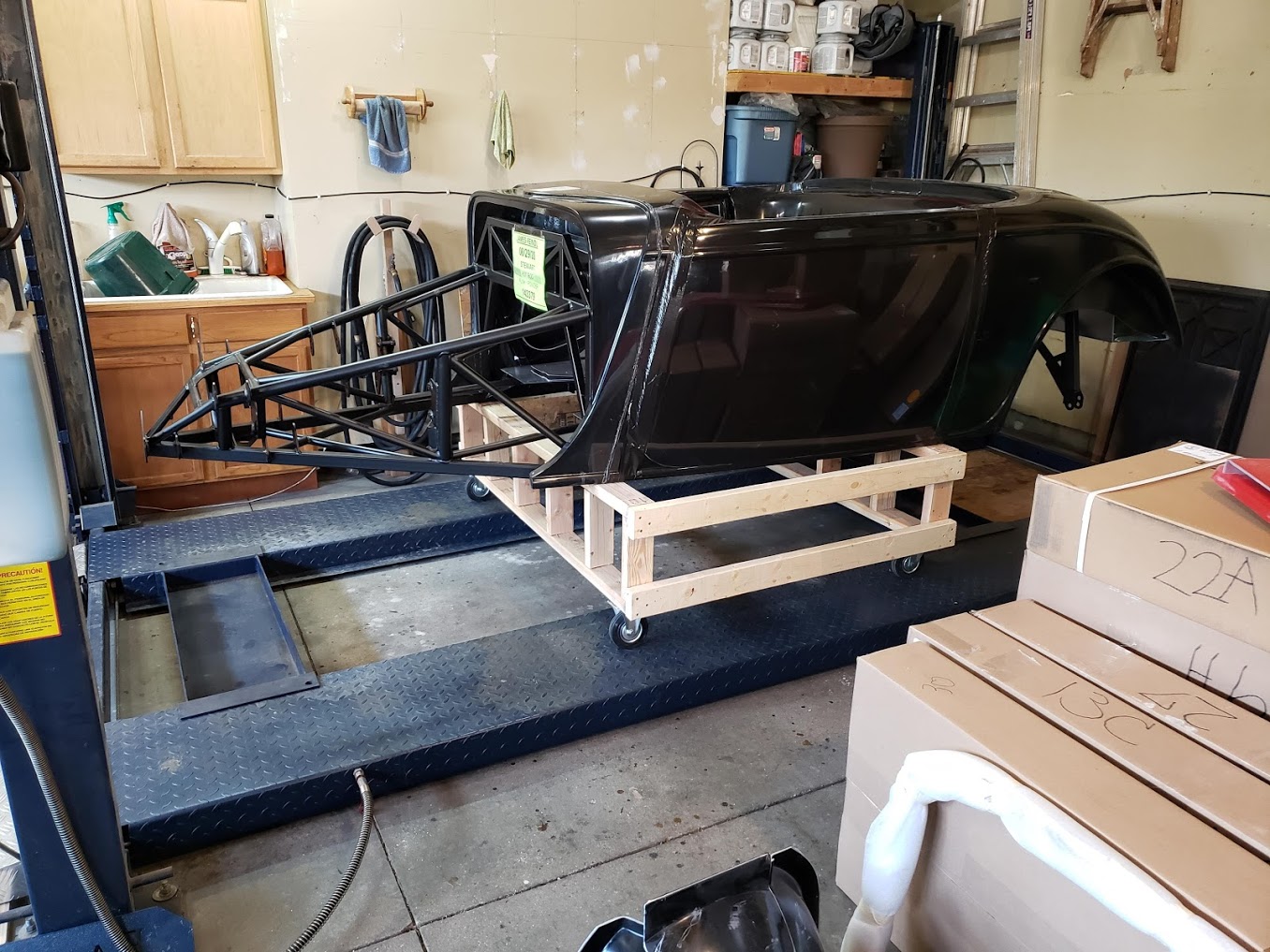

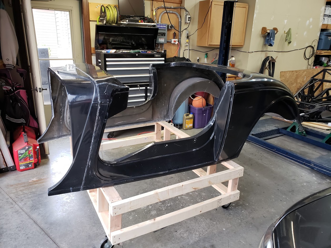

    On the lift, just need to get it back onto jack stands. The cart I made will come in handy for the body shell (may modify it a bit though)

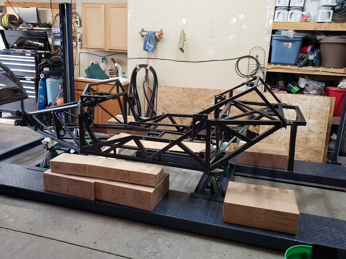

    The good news is I'm about 3/4 of the way through the 33 HR inventory, today I'll finish that up, store the boxes & body panels I don't need right now and get started.

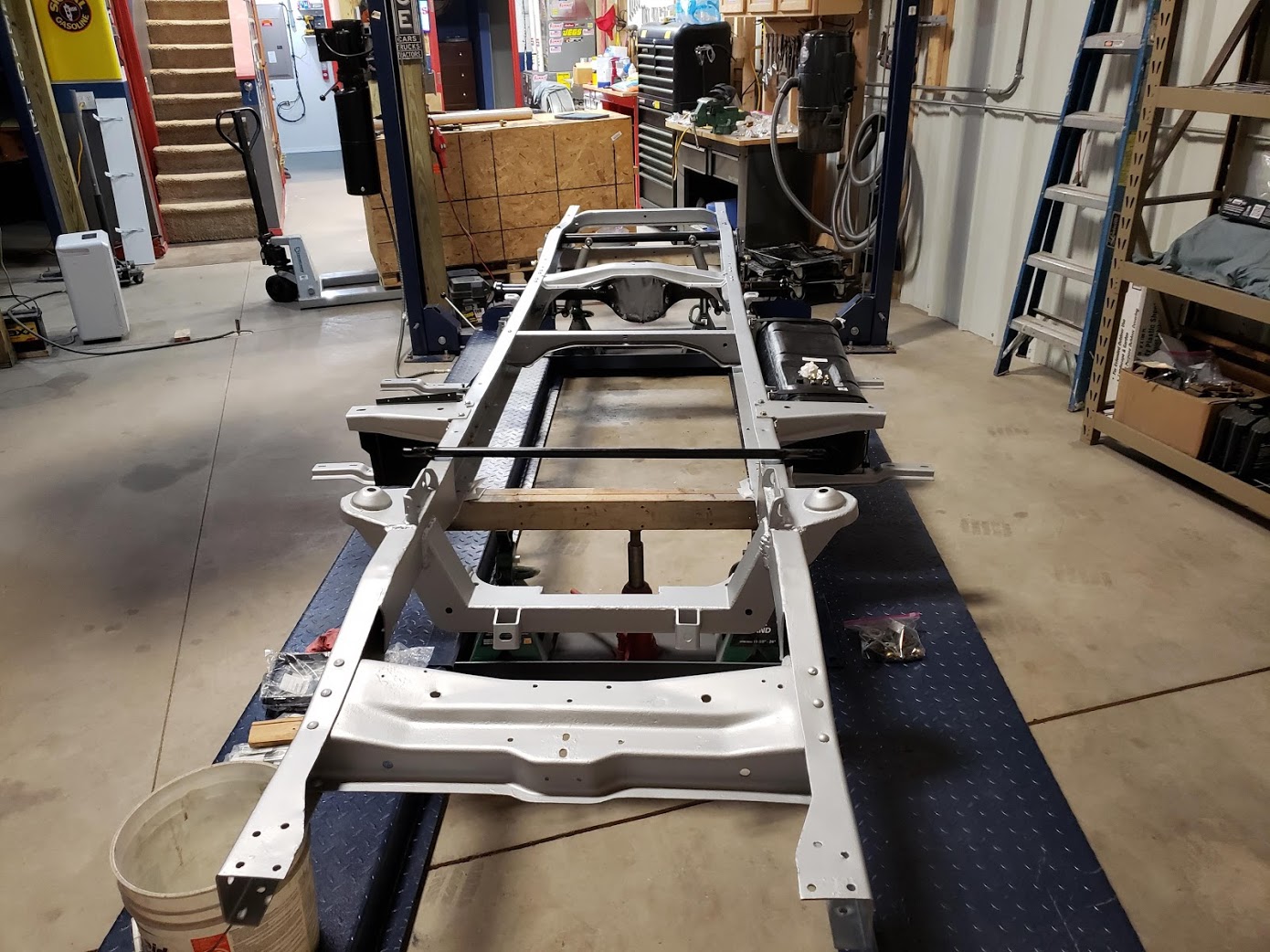

    Here's a quick shot of the current state of the 55 F100

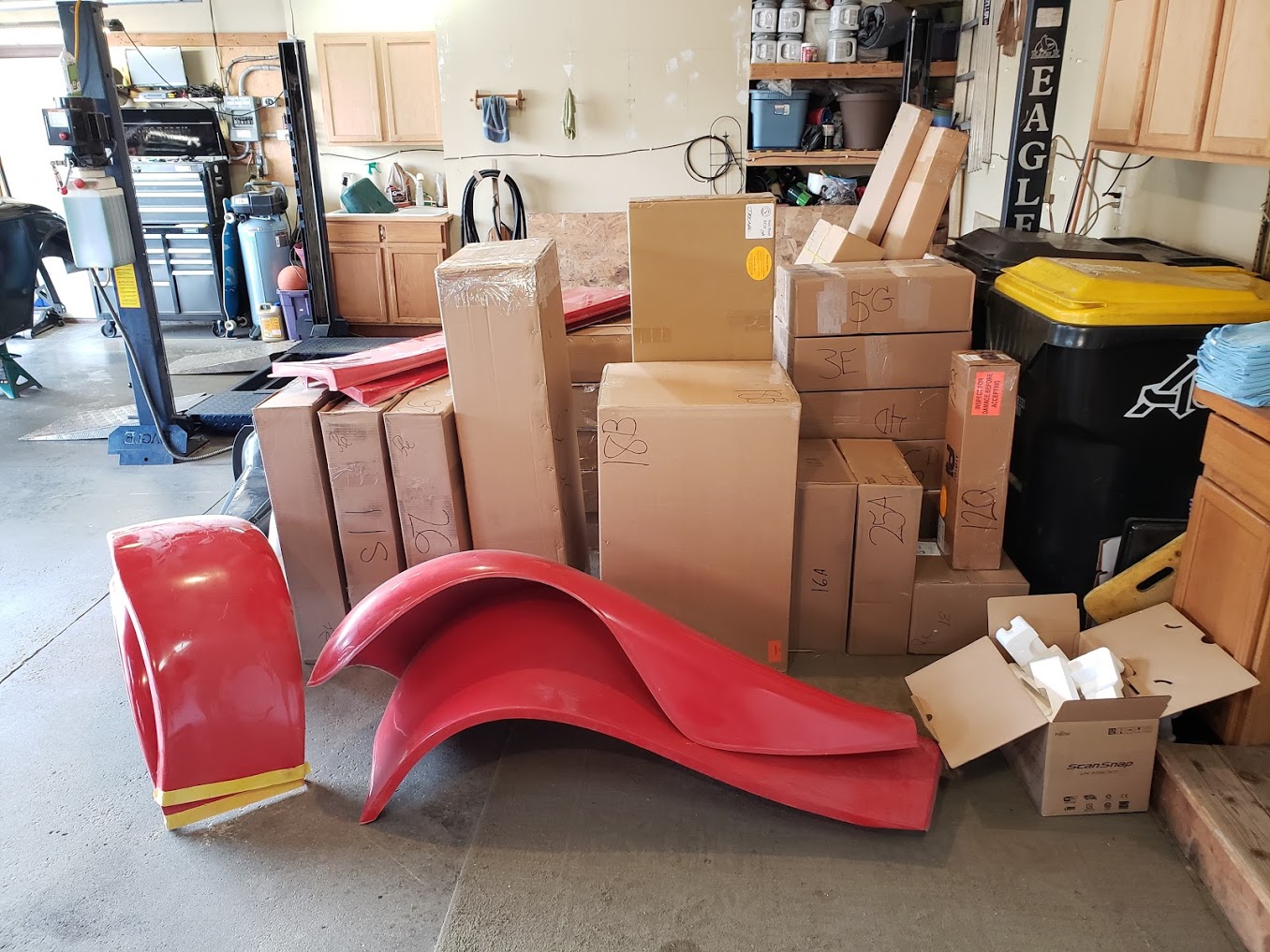

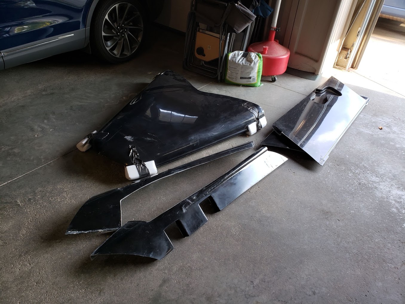

    Inventory finished earlier this morning, boxes and body panels not needed taken out to the shop and stored so they are out of the way. Body is off the frame. Basically I only left boxes for suspension, brakes and steering back at the house to start on. My upper control arms for the 4-link rear end are back ordered so I'll have to wait on that.

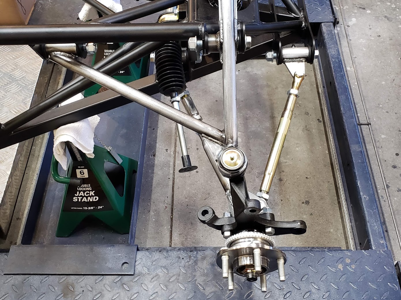

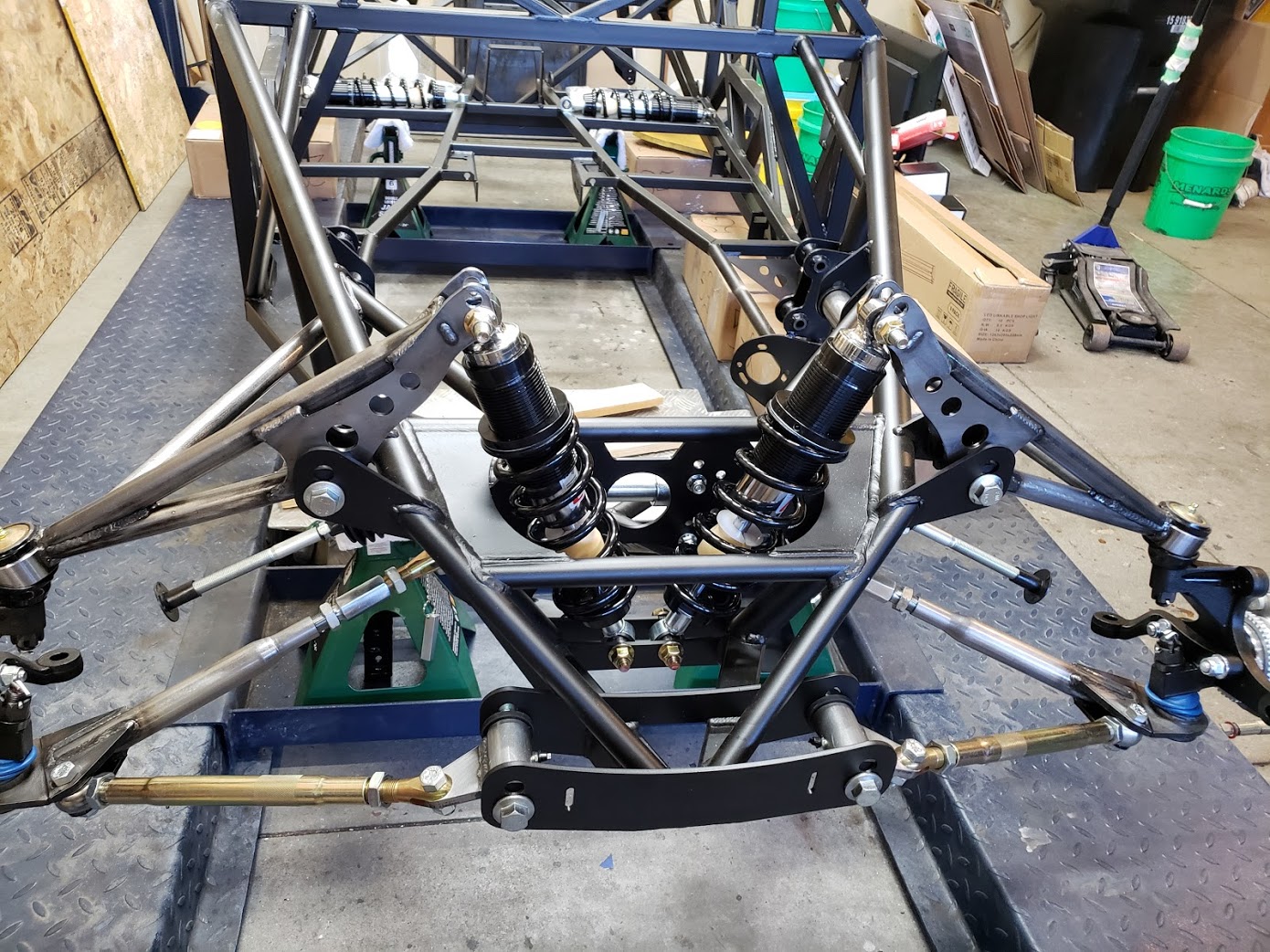

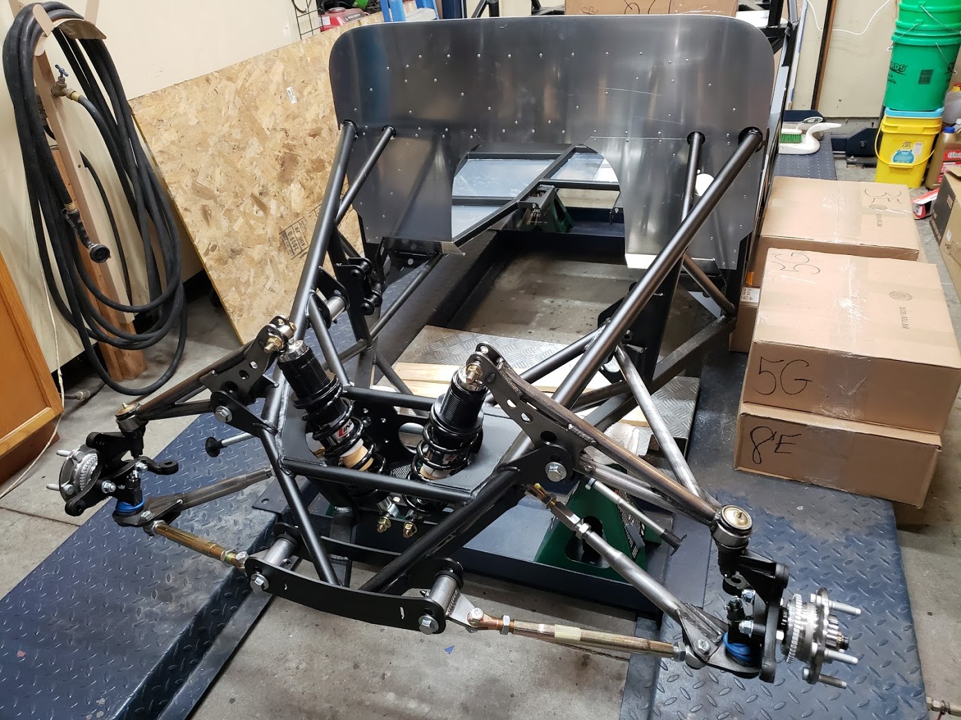

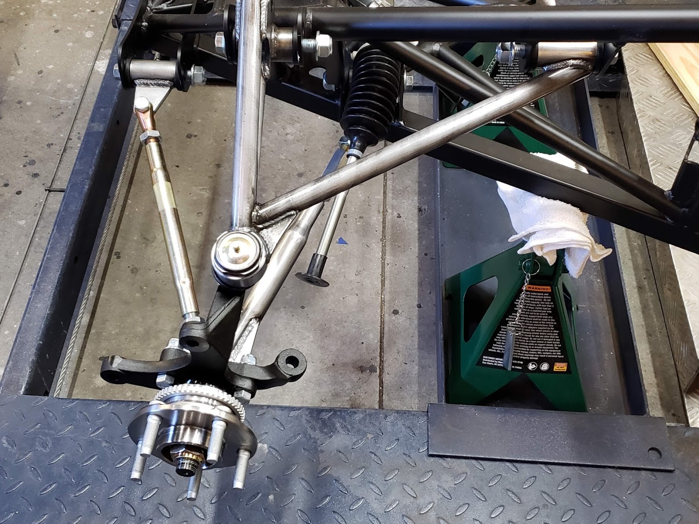

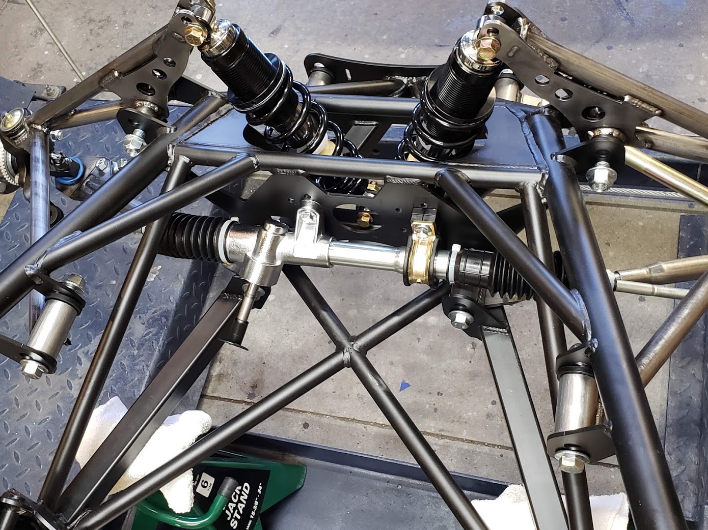

    Except for installing the tie-rods, front suspension & steering rack is installed. I decided not to powder coat or paint the upper & lower control arms, instead I cleaned them up, buffed them out and then cleared them...I like the look (not for everyone I know).

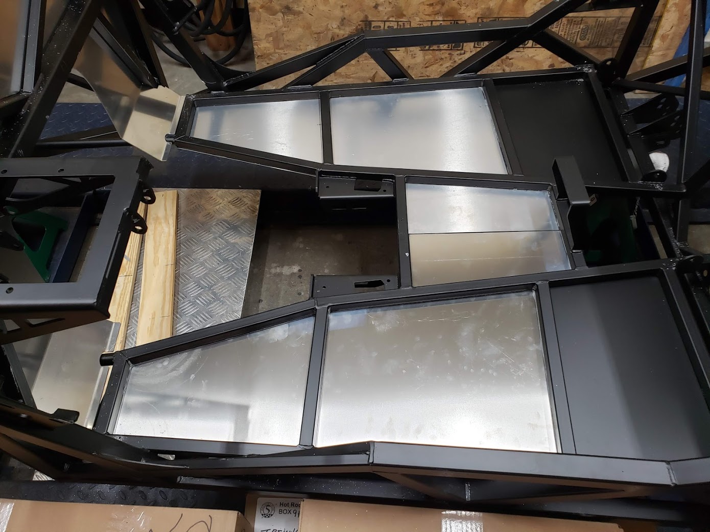

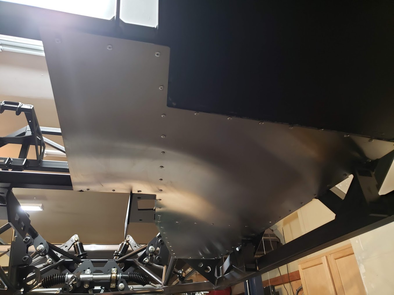

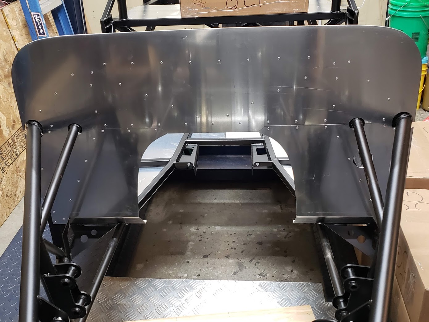

    Got the aluminum gas tank shelf installed last night along with the passenger side aluminum floor panel under the car.
    I'm glad I have a lift where I could work standing up...kudos to you all who did this laying on the ground, I couldn't imagine having to do this laying on the ground. Having bursitis in the shoulders I'm feeling it this morning, just glad I only have the driver's side left.
    One question......did you guys run a bead of clear seam sealer around the bottom of the panel to keep moisture from getting between the panel and the frame?

    I used black RTV in cartridges for my caulking gun on the aluminum panels.
    I put it on the frame then riveted the panels.
    Yes, I used clear sealer under every panel.

    Thanks guys.....To be clear, I used panel bond between the frame and the aluminum sheets but I may also take clear seam sealer on the exterior of the floor panels where it meets the frame as well as the seam in the middle (will do the middle seam from the top so it's less obvious).
    Just seems like a susceptible area for moisture to get in and sit and eventually rot things out.

    Yes put sealer on the frame between it and every panel to cut down on rattle. I also used it at the seams between the panel. Note there is an aluminum colored GE Silicone II if you can find it.
    Do you have the FFR heat and sound insulation package? If so, there is a piece that goes between the gas tank and the aluminum underneath it. Now would be a good time to put that on. The manual has you installing the tank long before it talks about the insulation...
    Good tip...yes, I ordered the sound insulation package....... I'll dig out the insulation piece that goes under the tank.

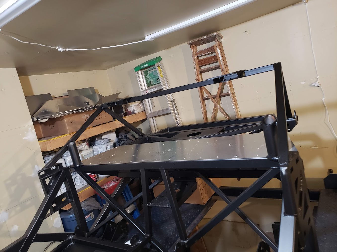

    Driver's side floor board installed (Yay, no more bottom side drilling / riveting). Also got the firewall installed. It came with some scratches on it so I'll need to figure out if I can buff those out, otherwise I may just paint it. Also need to drill the hole for the clutch cable yet.
    Probably this weekend I'll do some of the interior aluminum panels (Waiting on the 3M 5200 sealant to arrive for the internal foam).

    Quote Originally Posted by FF33rod View Post
    Hi Steve
    Do you happen to remember the shape of that insulation piece between the aluminum and the gas tank? I brought the box home from storage thinking how hard can it be to find that piece of insulation mat and nothing in the box resembles the shape of the gas tank shelf. It's a bit embarrassing to say i'm being tripped up by a piece of insulation mat.
  59. #38

    Quote Originally Posted by 33fromSD View Post
    Hi Steve
    I didn’t get any insulation between the aluminum panel and gas tank. Looking at the manual and figuring out where they all go there wasn’t a piece in my kit or one shown in my manual. Maybe is it included in the Gen 2 kit?
